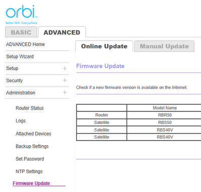

    I have an ORBI RBR50 with 2 satellites that is not giving me a strong signal throughout the house. Does the firmware need updated? If so, how to update a firmware?
    Firmware version does not change the physical design of the WiFi router.  As the satellites are now about 30 ft. from the router, pushing them farther away will extend the WiFi coverage a bit, but will also reduce the communication rate between router and satellites a bit.  It is a "balancing act".
    If the goal is to provide WiFi to non-mobile devices (which do not move around like phones, tablets, and laptops do), then a simple WiFi Extender is an inexpensive way to extend coverage.  Amazon carries WiFi extenders with prices from $15 to  (very expensive).  The reason mesh WiFi was created was to allow mobile devices to roam seamlessly between WiFi units.  Before about 2016, WiFi extenders were the common solution and people were annoyed when they had to turn the WiFi off and back on again to keep good performance on mobile devices as they moved around the house.
    The Orbi web interface has a method to update firmware to the latest version:
