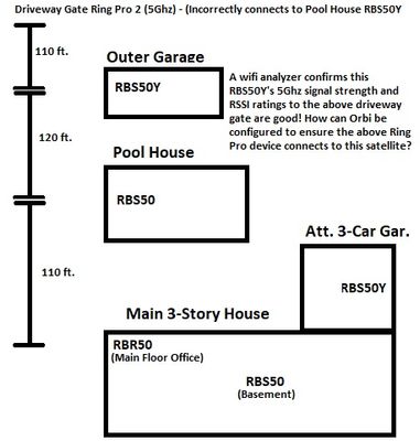

      Ekhalil: Your thoughtful response prompted additional research and questions regarding other creative options that might be available for helping steer wifi devices to the most optimal Orbi router, indoor satellite, or outdoor satellite. Below is an illustration of the problem and some questions for possibly creatively managing the most appropriate Orbi router, indoor satellitle, or outdoor satellite that wifi devices connectd to. I welcome your and/or others' responses!
      Can One or More of the Following Methods Be Used to Manage What Orbi Router or Satellite a WiFi Device Connects To?
      1. Can Orbi's ability to disallow the connection of specific wifi devices be applied to one or more specific Orbi devices (e.g. Orbi main router, Orbi indoor satellites, outdoor satellites)?
      2. Is a third-party software tool/method available (e.g. via Telnet, etc.) to help wifi devices connect to the most optimal Orbi device?
      3. Can Orbi's transmit power control be applied to specific Orbi indoor and/or outdoor satellites?
      4. Are there any other methods for helping to ensure that wifi devices cannot to a specific wifi device?
