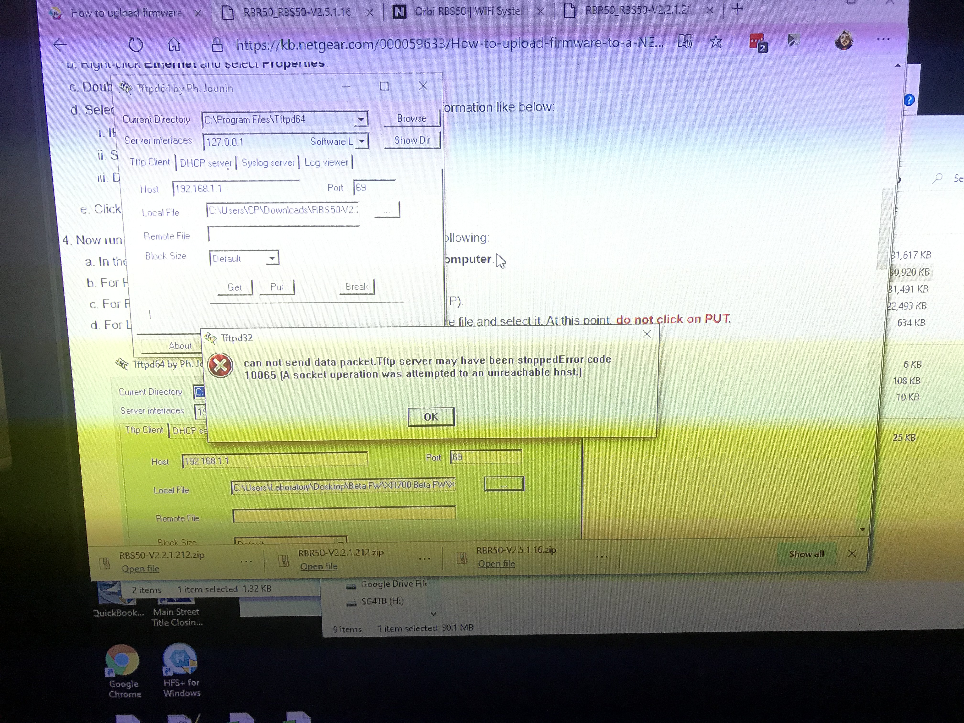

    The version I mentioned before was for the satellites. When I plug in the ethernet cord from PC to Satellite and try to send the firmware update manually, I get this error:
    can not send data packet. Tftp server may have been stopped. Error code 10065 (A socket operation was attempted to an unreachable host.)
    (Image of error is attached)
    Any ideas?

        OK so I already did the factory reset button push before trying to do the satellite that was unsuccessful. Why the warning about not pushing the reset button? What to do now?
        I am needing to maximize speed over a very far range. Is Voxel hands down an improvement for this or not a guaranteed improvement? If 50/50 odds, I'd prefer the stock firmware for the sake of it auto-updating. (Voxel cannot, correct?)
        Is https://kb.netgear.com/000059633/How-to-upload-firmware-to-a-NETGEAR-router-using-TFTP-client accurate? It's what I followed but the satellite change from Voxel to factory wasn't successful - with the error message previously sent. Is this error a result of my pushing the reset button?
