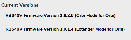

        The RBS40V (without the '200') and the RBS40V-200 both appear to have two different firmware versions:
        Yet they have entirely different installation directions:

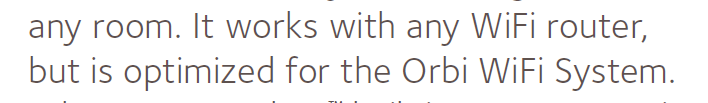

        The Product Data Sheet for this model adds "works with any WiFi router":
