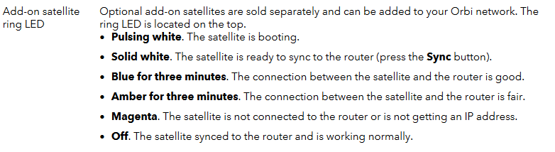

This entire time the satellite is stuck at a pulsing white LED.

    The RBR50 User Manual describes the satellite ring LED states:
    Assuming that the satellite is not connected to the router with Ethernet, I also like to temporarily relocate the satellite to be close to the router in order to make it more convenient to observe what is going on.
    It might be worth performing a Factory Reset on the satellite. (holding an object in that tiny 'Reset' hole until the power LED turns amber and begins to blink.  Then release.)  No need to touch any sync buttons.  If the ring LED continues to flash white for more than 2 minutes, there is definitely a problem.
