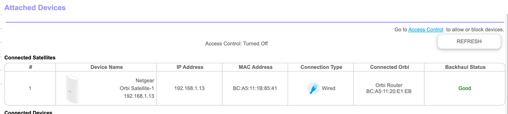

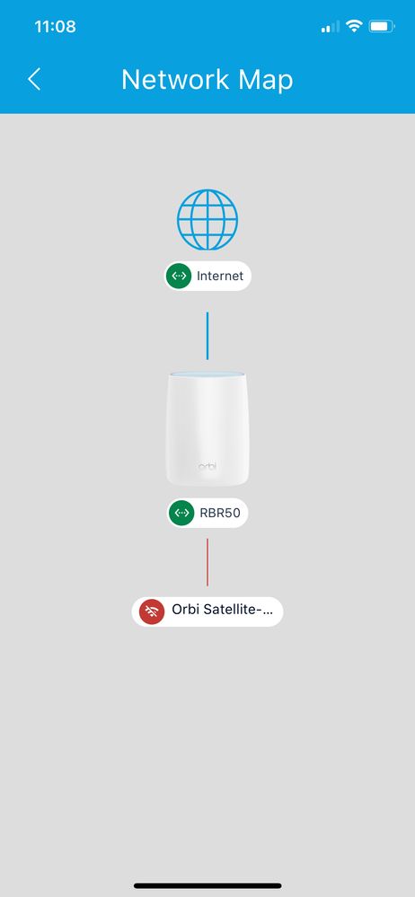

hard-Reset and hardwired the satellite -- it still won't sync.
Attached screen grabs from the browser (which shows it connected) and the app (which shows it not).
