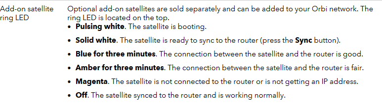

Page 10 of the Orbi manual shows this:
So, the Orbi web interface says the satellite has a "Good" connection. The satellite displays a Blue ring light. These would tend to indicate that the satellite is in fact connected and the 'app' is mistaken.
Sad that you have no device with an Ethernet port. If a device is connected to the satellite with a cable, and appears on the Attached Devices display as connected to the satellite (and "works") then that would be even more evidence that the satellite is connected and the 'app' is mistaken. (There's nothing in the house with an Ethernet port? AppleTV? DVD player? TV Set?)

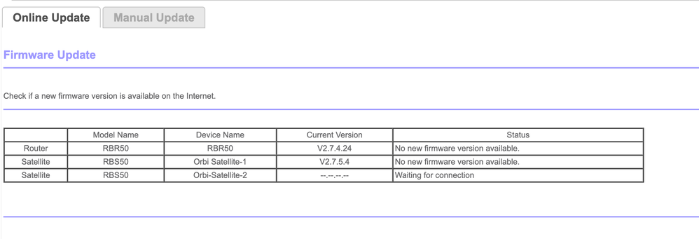

The FW upgrade worked for one satellite and I'm on the 7th time trying the second one in hopes I can update its FW also.
The browser status indicates "waiting for connection" :
...even though the lights on the top have gone from solid green to solid blue during the sync process.
