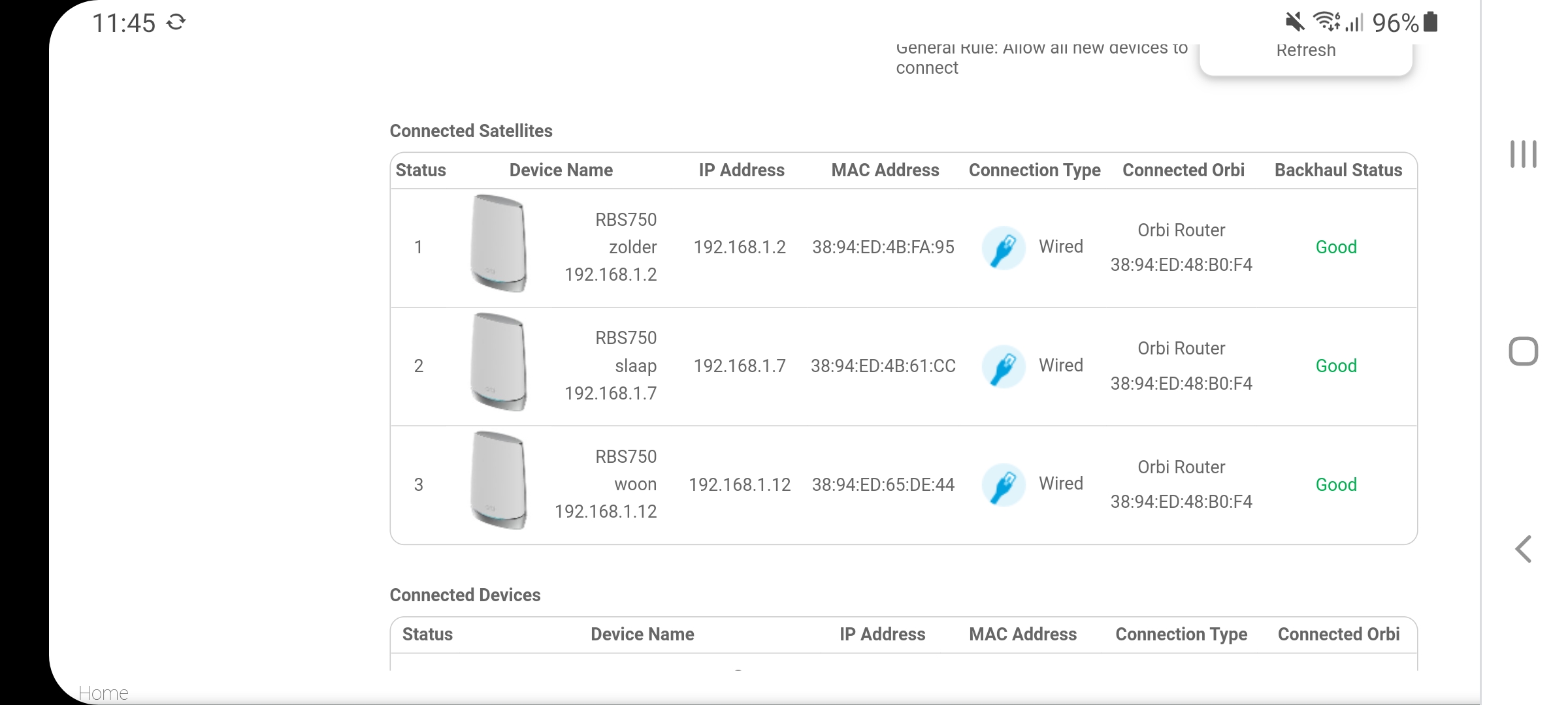

RBS750 ax4200 back haul wired out of sync after a while
I have a RBR directly connected to 3 RBS. 1 of the RBS is always out of sync. When I start it up it stated backhaul wired is good, but after a while it goes out of sync.
What I've done so far:
- Updated firmware, now all the same with newest version
- Changed the RBS to different locations in house to others which do work properly
- Reset the RBS
- Disconnected and connected the RBS
- Wireless connection
None of it worked so far

Is it always the same satellite that goes out of sync?
What if it changes places with one of the other satellites.
Does the problem go with the satellite, or stay with the location?
- BjornMoAspirantHi Crimpon,
Thanks for getting back.
Yes, always the same satelitte, even when swapping to other places. The same satelitte has the issue, others work fine on all locations.
The satelitte not working properly is the add on (same model, version rbs750 ax4200) as the others, but the others came with the router.- BjornMoAspirant
