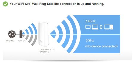

Satellite connecting at 2.4 Mhz
I recently bought the RBW30 (firmware V2.0.0.34_1.0.21) wall satellite to add to my ORBI network. It has connected to the router (RBK50, firmware V2.0.0.74) but at 2.4Ghz not 5GHz. see following pic;...

Problem solved. Factory reset corrected problem and updated region from Europe to Australia correctly.

because wireless ac 5 gig is very sensitive to overload and interference
the image is still not showing but when you access the 30's gui what does it show on the backhaul

Not sure why this image is not showing for you. Works find for me...
The backhaul, if I understand you the connection from the orbi wall plug satellite back to the router, shows a wireless connection symbol with the upper part in blue (2.4 GhZ) and the bottom part greyed (looks like the 5 GHz section)
