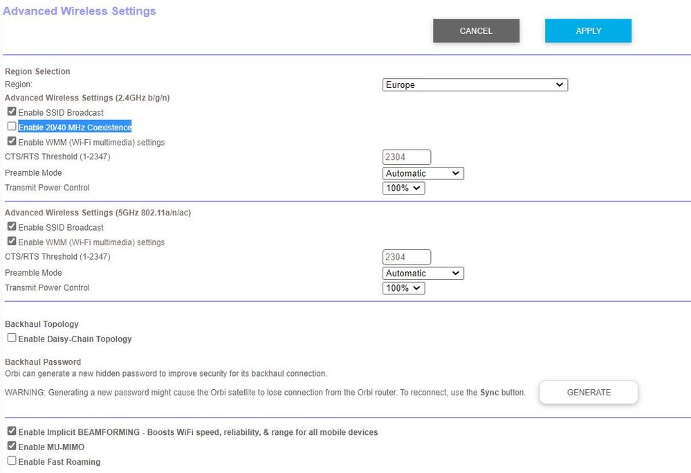

I have 1 RBR50 and two satellites. One satellite in kitchen and the other on the first floor. My router is in the fuse box.
Latest firmware.
Sometimes i have internet drop outs.
Support desk told me to remove 1 satellite. Because my house was to small so the satellites where competing each orther. Sinds then my connection is more stable (still somtimes dropouts in kitchen).
i am not sure this is a reliable solution. And now i have a spare RBR50 ;-).
Coverage is acceptable.  Is there anybody with the same experience?
I sounds as a strange solution that satellites are competing......
See my settings below.
Fixed chanels for 2.4 at channel 6
And  5 at channel 48

    • NESSHINDO's avatar
      NESSHINDO
      Thanks very much  Furry !
      Do you measuse the square feet by adding each floot to the sum? Groundfloor is 1000 square feet. I have three floors.
      My firmware is V2.5.2.4
      Internet provider is KPN (Netherlands).  My modem is a Sagemcom F5359. Internet connection is glass fiber. (500Mbit up and down). My NG is in Router mode. My modem has unforntunalty nu bridge function so a placed met NG router with fixed IP adress in the DMZ and deleted portforwards on the Modem/Router by KPN.
      Distance between my NGRouter and satellity is about 10 Meters.
      Maybe to much overkill in my home for two satellites ;-) Thinking about selling the second one. But if this is the case: how is it possible that the devices are interfering? Mesh should solve this issues i thought?
