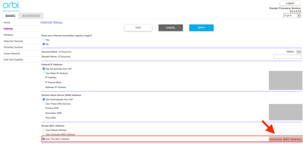

      gszakacs If you can't release the IP address in the Actiontec as explained above by nwaves, then you can clone the MAC address of the Actiontec in Orbi as follows:
