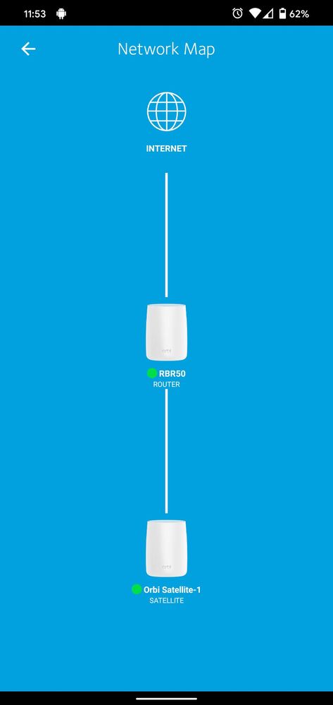

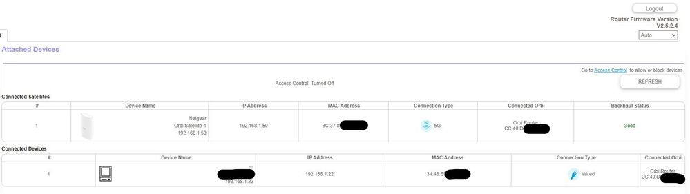

I reset to factory defaults and have now set the RBR50 to router mode. I have a CAT 6 cable connected directly to the RBR50 and RBS50. Status is still showing "5g" not "Wired"
Dec 15, 2020Guru - Experienced User
You need to downgrade to v16 if you want ethernet backhaul to work:
- jvetroDec 15, 2020TutorTo confirm, I need to downgrade firmware in order for the status to show wired or to use Ethernet Backhaul period?
- FURRYe38Dec 16, 2020Guru - Experienced User
Both.
There is a bug in FW after v16 which seems to cause problems with RBS that are ethernet connected. Something not seen with v16 FW.
- jvetroDec 16, 2020TutorThank you. I am going to install on the weekend and replace the isp router with this!
