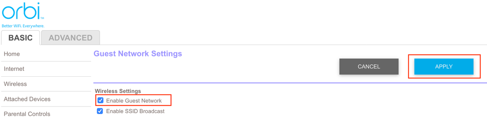

- ekhalilMaster
When disabling (or enabling) the guest network by toggling the tick in the ssettings you nned to do "Apply" and the system will reboot to apply the settings, otherwise the setting will still be there and will only take effect after a reboot.
Can it be that when you first unticked the guest network you did not click on "Apply"?

- st_shawMaster
It appears to be a bug. I've seen it twice so far. Once in a while one of my satellites will start broadcasting the unsecured guest network. Rebooting the offending satellite resolves the issue. When it first happened, I connected to the guest SSID and there was no IP address given to my computer, and no access to the LAN, so I'm not too worried about it myself. Seems like it could be a startup problem with the satellite configuration after a power outage.
There was a recent post that someone said that the GN SSID comes from a unsynced or improperly synced satellite(s). They said that the satellite needs to be removed from the Orbi router, do a factory reset ON the satellite, then re-add it. Apparently if the satellite is not correctly synced with the router, it's doen't get the correct configuration from the base router and GN is broadcast. Please give this a try and let us know if the GN disappears or not.
Ensure Guest Network and SSID Broadcast IS unchecked and applied ON the router as well.
