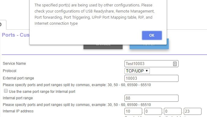

Like many, I made the mistake of getting an Orbi system. It drops constantly and is unreliable, and I'll need to replace it soon, because it's clearly not ready for primetime. Until that day, I'd like to sort out an issue I don't understand. I have multiple devices on my network that accept connections on port 80. I've assigned them discrete IP addresses. On my old Nighthawk, I simply routed unique external ports to specific ips on port 80, and everything was great. But the Orbi refuses to allow that configuration, giving me the classic "The specified port(s) are being used by other configurations. Please check your configurations of USB Readyshare, Remote Management, Port forwarding, Port Triggering, UPnP Port Mapping table, RIP, and Internet connection type" error. But that error does not make sense. I should be able to confgure multiple unique external ports to specific unique ip addresses on port 80:
External:10001 -> 10.0.0.1:80
External:10002 -> 10.0.0.2:80
etc
I've done this on every router I've ever owned, including NetGear products. Why won't Orbi allow this?
Thank you for your help.

  • Can you send us a screenshot of what you're trying to do?  It should work.  Here you can see I've been able to port forward to 3389 on two different internal hosts, using different external ports (3389 and 3390).  I also did it to port 80 for two different hosts, using external ports 80 and 81.

      Thank you for the response. Your screenshot looks exactly like what I expect to happen. Here's how mine looks. The first image shows a forward from external 10002 to internal 10.0.0.22:88. The second shows a failed attempt to add external 10003 to internal 10.0.0.23:88. Of note, I'm on the same firmware as you: V2.1.4.16

    See my posts in this thread for the solution. You need to create a custom service, otherwise the router thinks you are trying to forward the "http" service more than once.
    https://community.netgear.com/t5/Orbi/Orbi-port-forwarding-not-working-on-multiple-ports/m-p/1603813#M35512

      Thank you for the advice. I apologize if I'm misunderstanding your post, but I believe I'm already trying to create a custom service. See my screenshots where it won't let me create a new service that forwards to a port being used by another service (even though it's two unique IPs).
