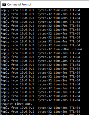

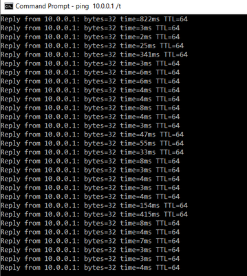

Issue: Intermittent latency spikes and timeouts when connected via WiFi to Orbi mesh network.
Impact: Makes voice communications (e.g. - Teams, Discord) sound robotic at times. Makes online games unplayable. Streaming services, such as Netflix, are not noticably impacted. This has only started occurring in the last week or so.
Example Screenshots

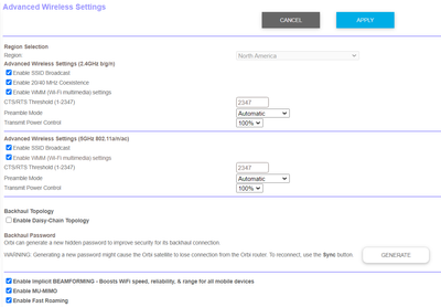

Orbi Settings:
- Router mode
- 2.4Ghz network enabled, channel auto-select
- 5Ghz network enabled, channel 48

- Constant ping to Orbi router from multiple WiFi connected clients (different laptops) and received latency spikes and dropped packets across different client systems.
- Toggled and tweaked various Orbi settings. (e.g. - Enabling/disabling daisy chaining, MU MIMO, fast roaming, implicit beamforming, WMM). Current settings are noted above.
