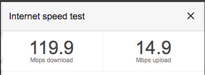

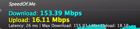

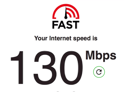

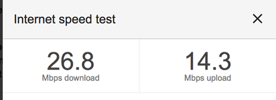

      I did three tests using an ethernet cable, I ran a test on my modem, ORBI router and Satellite and they all gave me close results. I ran these test on a Lenovo and MacBook Pro. I then ran speed test using the Wifi on both computers and the results were slow.
      I am attaching the speed test screenshots that i ran using a cable connected to the Satellite, as well as the results I ran using my MacBook Pro using WiFi.
