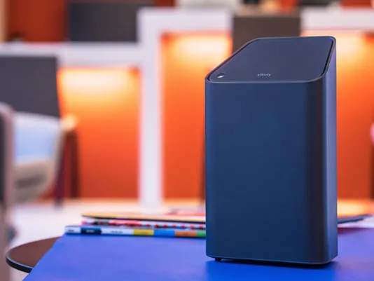

Thank you for the reply. You are correct in that I don't want a modem/router combo.
I am renting the Comcast modem-it looks like this. It's a cable modem. Thanks again for the reply! Judy
