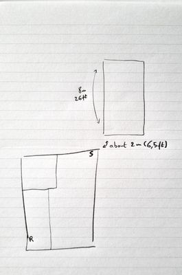

    More detail about the physical layout would help.
    • is it possible to provide a rough drawing of these buildings, and
    • indicate the distances involved?
    • Is there a single WiFi access point in one building and the remote building has no access points?

    • petermorlion's avatar
      petermorlion
      I made a rough sketch, with distances that should be about right (in meter and feet). At the bottom left, the "R" indicates my Orbi router. In the top left of the first building, the "S" indicates a satellite. There is a satellite on the second floor as well, practically above the router.
      The distance between the router and the satellite on the drawing is about 14.5m or 47.5 feet. The distance between the two buildings is about 2m or 6.ft.
      Now, because I had this problem in the past, I purchased an extra satellite and placed it in the top building, in the top left corner. I had the impression that the satellite had trouble connecting, so I added a powerline-adapter between the two buildings. But like I said, they have their own electrical switchboards so the data has to go through the differential switch, which is what slows it down, from what I read.

  • I finally got round to trying out several options and in the end it was quite simple, as proposed in the reply I marked as answer. I moved two satellites so that they could "see" each other through windows. Before, the signal had to move through exterior walls. Now that there's a straight line between them that only passes through glass (even though they are about 5-10m further apart), it seems to be working much better.
