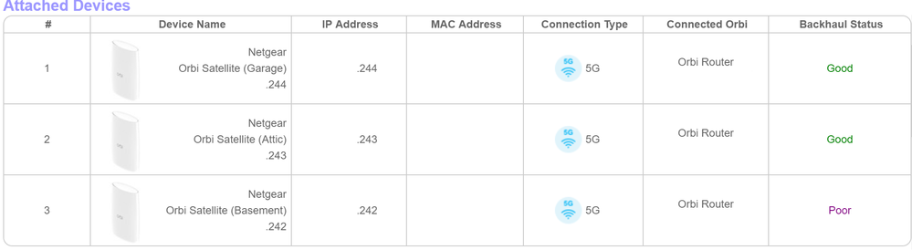

Have been using the Orbi system with three satellites for some time now (successfully).  The Orbi Router & two of the satellites (running in AP Mode) are hard wired to a Cisco Switch & configured to use the wired backhaul.  The Orbi Satellite in the garage is wireless.
After having some HVAC work done yesterday (power cycling circuits in the house) I am unable to get the wired satellite backhaul back up.  No matter what I seem to try, the Orbi GUI reports the satellites are connecting wirelessly.  Any thoughts on how to resolve this?

      Satellites were connecting wirelessly to the Orbi Router in Access Point mode.  To fix, I resynched each of the Orbi Satellites to the Orbi Router (with Ethernet unplugged).  After about 15 minutes, I went back & plugged the ethernet cords (wired backhaul) back in.  After 15 minutes, the backhaul had not changed over to wired so I powercycled the satellites (with the ethernet backhaul plugged in).  Within 15 minutes, the wired backhaul was back up & running.

      IGMP snooping protocols are not enabled on the switch; never have been.  The managed Cisco switch is not the issue, it's Netgear Orbi Firmware.
      After messing around with it for two hours & failing to bring the wired backhaul back up, I downgraded the firmware back to 2.1.4.10.  The wired backhaul instantly came back up.  Very frustrating.
