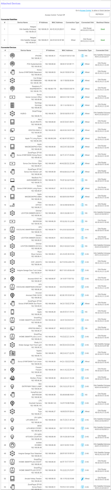

    Am I correct that Attached Devices shows all five cameras connected to the Orbi router and none connected to a satellite?
    If this is the case, I would try powering a camera off and then back on and see which unit it connects to.
    • aesterling's avatar
      aesterling
      CrimpOn thanks for the response. You are correct, all but one camera (Wyze) is connected to the router and not the satellite, even though most are much closer to the satellite. I will reboot the cameras and see if they switch to the satellite, check performance, and reply here. Thanks!

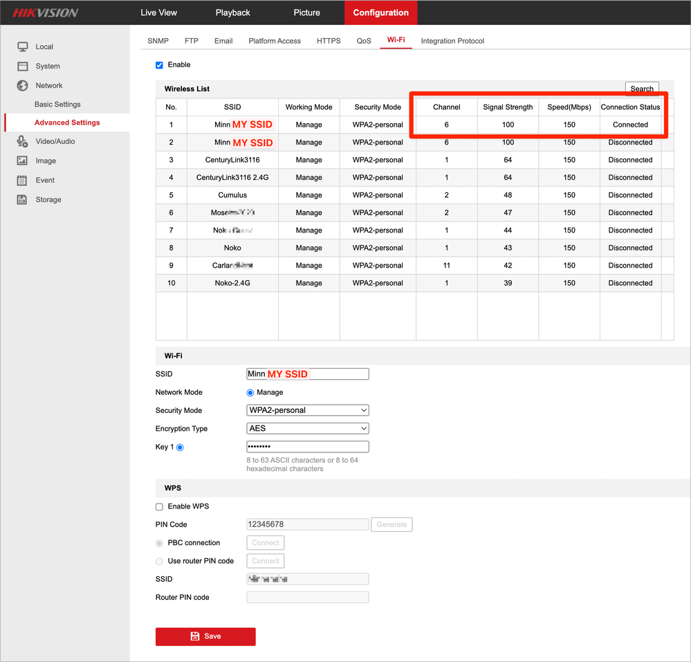

        Another interesting example is, after the reboot, I was watching a camera's live video and then attempted to also load the camera's web interface in my browser. As soon as I did so, the live stream from that camera stopped as well as the stream from other wireless cameras that are connected to that satellite. It's like the extra traffic from loading the webpage killed the signal to all of them momentarily.
        Here's a screenshot from one of the camera's web interfaces that shows the wifi networks and signal strength. At the top of the list it shows my SSID two times. The top one it's connected to shows a signal strength of 100.
