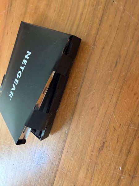

battery nighthawk m6 (mr6150) swelling
hi, got a 2.5 year old nighthawk m6 (mr6150) and just notices the battery starts dangerously swelling! this should not happen... it has just been sitting in a cabinet as backup. i bought it at...

boddeke wrote:this seems like a dangerous production problem of either the battery or the charging electronics.
Was the aircard on a charger? Or was it just sitting in the cabinet (not connected to anything)?
Battery swelling is a common sign of failure in a lithium battery - aging + humidity can cause it. But so can overcharging.
boddeke wrote:what should i do?
Obviously dispose of the battery. Be careful not to puncture it, as that can result in a fire.
If there is no sign of damage to the electronics inside the aircard, then it should be safe to replace the battery with a new one. Though I don't think you'll find many Netgear-branded replacements - googling shows mostly third-party replacements when I look.
