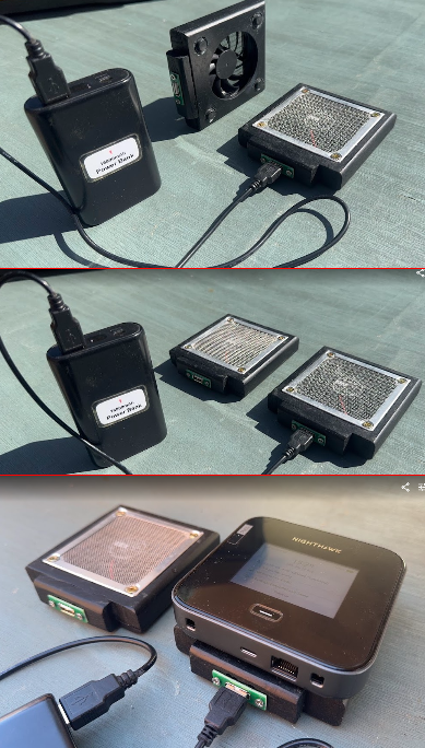

- FortraSep 11, 2026Luminary
Here is my bespoke (homemade) brushless and silent 5v USB coolers connected to a USB external battery.
