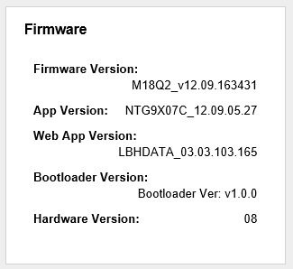

A new firmware has been posted on the update servers that fixes the LB bridge mode issue. To update LB1120, LB1121 or LB2120 to latest Firmware log into the LB web ui and go to Settings àGeneral à Software and Reset once there select check for update and wait then simply follow onscreen instructions to update the Firmware. See below for example of how the LB2120 Firmware Info screen looks like after update. For other device just need to make sure that you are using App Version: NTG9X07C_12.09.05.27

rini-kl Yes this is available for both LB1120, LB1121, LB210. If you are using LB2120 if you are on the latest FW you should see the following info under firmware on the about screen.
If you were part of testing any beta FW for LB2120 it is possible that your device maybe restricted from getting the latest update. If your info does not reflect what was shown in screenshot above my suggestion would be to either contact support about it or reach out to DarrenM the AirCard mod and provide him with your IMEI and SN so it can be checked against NETGEAR’s update server.
