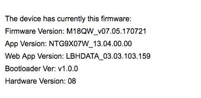

- ssstofffDec 19, 2017Aspirant
I'm having the exact same issue with a LB2120.
The firmware details are this:Firmware Version: M18QW_v07.05.170721
App Version: NTG9X07W_13.04.00.00
Web App Version: LBHDATA_03.03.103.159
Bootloader Ver: v1.0.0
Hardware Version: 08There are nu updates available.

- ssstofffJan 07, 2018Aspirant
Hi, these are the technical details of my device. I bought it in Belgium.
