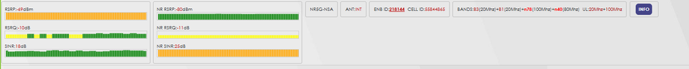

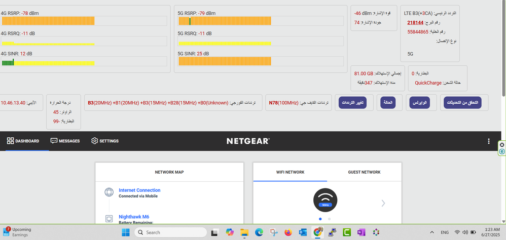

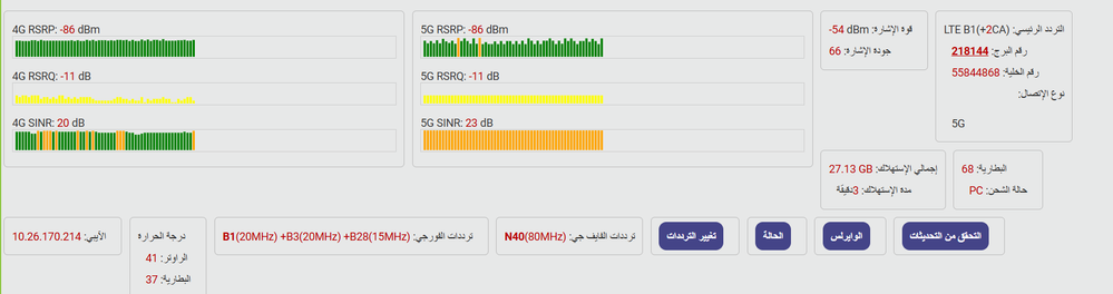

I have a Netgear M6 modem (model 6110-111 EUS) that is currently connecting to only one 5G band at a time.
It connects either to N40 or N78, and I would like to know how I can configure it to connect to both bands simultaneously. (attached)
I have also noticed that there is an LTE (B0 unknown) band that connects back and forth frequently, which affects CA performance. (attached)

I have also tested other 5G modem brands and confirmed that the cellular tower near me is capable of supporting 5G on both bands simultaneously. (attached)

B3+B1+B3+B28+B0 unknown+N78other modems ENDC for both N40+N78+B1+B3
B1+B3+B28+N40
