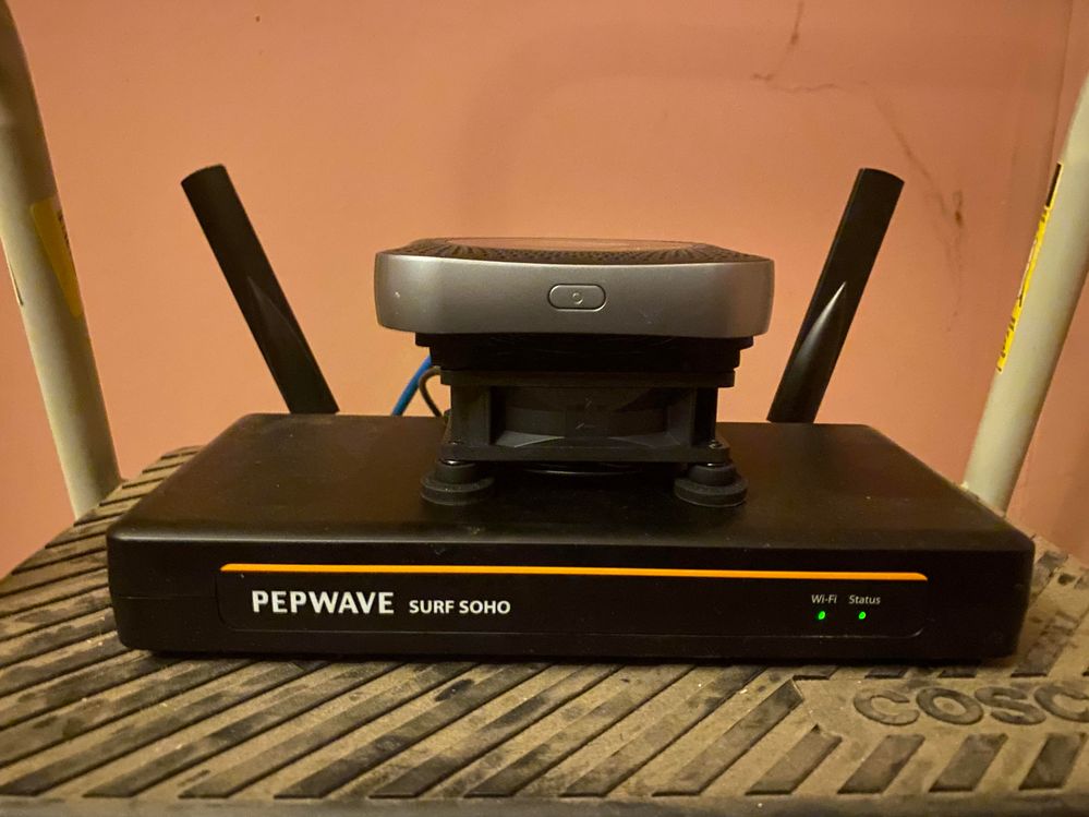

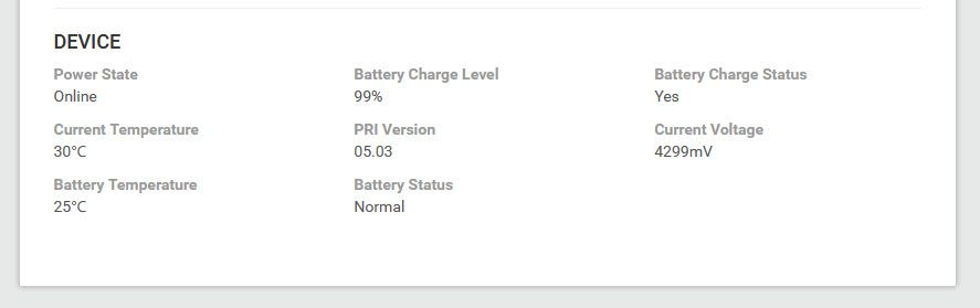

        So after all said and done, I was still having issue with battery charging. The MR1100 would get to about 33% charge and then discontinue with overheat mode. I solved that issue very easily by shutting modem off for a couple of hours. I then tired a different trick by adding a cooling fan from AC Infinity that fits nicely between my router and the MR1100. It now registers a much cooler temp and will charge while the unit is being used. Only $13 on Amazon. Voila!!!
