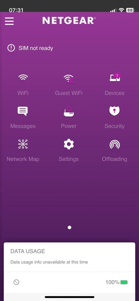

#1 is the screen of the app when the SIM is not properly recognized

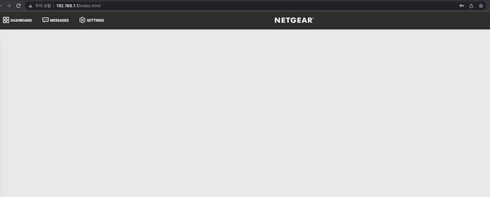

#2 is the app screen with no SIM attached

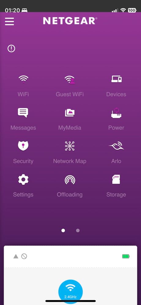

#3 is the screen of the device when the SIM is not properly recognized.

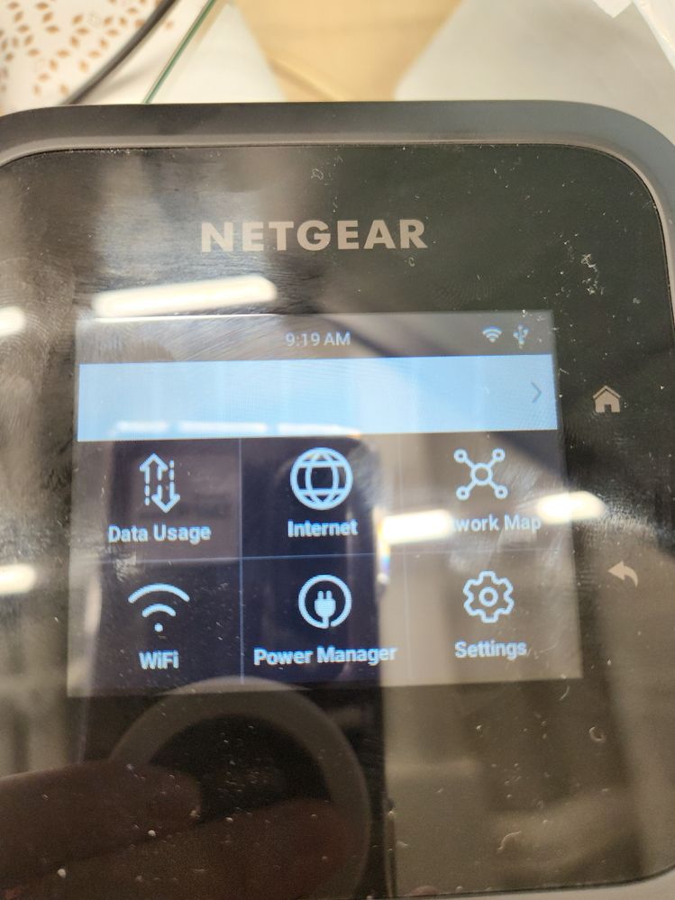

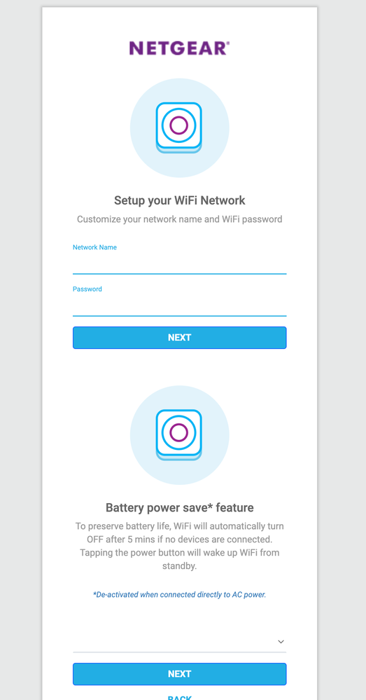

#4 and #5 occurred after the device was initialized and all settings were completed.

And I want to check what kind of problem there is with the same phenomenon as #1 and #3.
When the SIM is not recognized, the management page does not work like #4 and #5.
