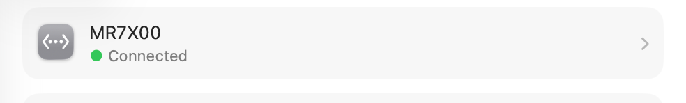

USB tethering remains fully functional after being disabled. I have set the touchscreen control at Settings > More > USB Tethering to OFF, and the web UI at Mobile Router Setup > Use USB port for to Charge only. Both settings save and persist across device restarts. Despite that, the hotspot continues presenting a USB network function to the connected Mac.
Verified in ioreg while both settings were in place:
"USB Vendor Name" = "Netgear" "USB Product Name" = "MR7X00" "USB Serial Number" = "c5ff0a77"
The Mac receives 192.168.1.4 by DHCP from the hotspot, which the user manual identifies as the address assigned to a USB tethered client. Traffic bound explicitly to that interface reaches the internet and returns:
ping -b en19 -c 3 8.8.8.8 3 packets transmitted, 3 packets received, 0.0% packet loss
I restarted the Mac with both settings in place and the interface came back up unchanged, so this is not stale state on the client side.
Impact: I use the 2.5G Ethernet port as my data path to the same Mac. Because the tethering interface comes up anyway, the Mac ends up with two interfaces on 192.168.1.0/24, both gatewayed at 192.168.1.1 with the same DNS and IPv6 prefix. I have had to disable the network service on the Mac to work around it, and that does not survive a hotspot restart.

Screenshots of both settings attached.
