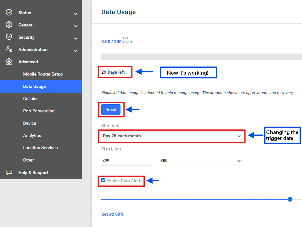

I have purchased a Netgear MR7450 mobile router, it's working as it should. However, the problem I have with it, within the Advanced option Data Usage is that it's NOT showing the number of (0 Day's left). I have included a screen shot of the problem. I have setup the selected trigger date for it to reset, for the month but it still doesn't change.
Both Configured Apps installed, on my mobile phone. of which in turn will be giving me access to the "various router hardware devices" that in connected on the same network!

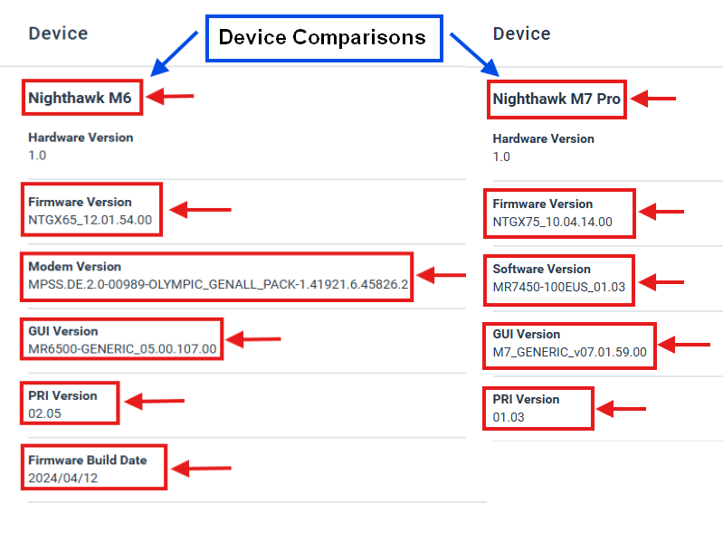

Additional information to above post above, I have included within the screen shot that is highlighted with a RED borders. The current firmware MR7450 that hardware is using, and my current SIM that is installed. At the moment there is NO update firmware for this device. Hopefully in the future they will provide one at some point. I'll just have to wait and see!

Addition information listed here, I have both M6 Pro and M7 Pro device hardware.

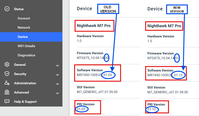

What to take a note of, and also lookout for your (MR7450) device.
- FortraLuminary
Please note, that the updated post above comparisons. Highlighted with a BLUE borders. These updates are gradual minor updates. Keep a lookout for those major updates that will cure. The reported problem!

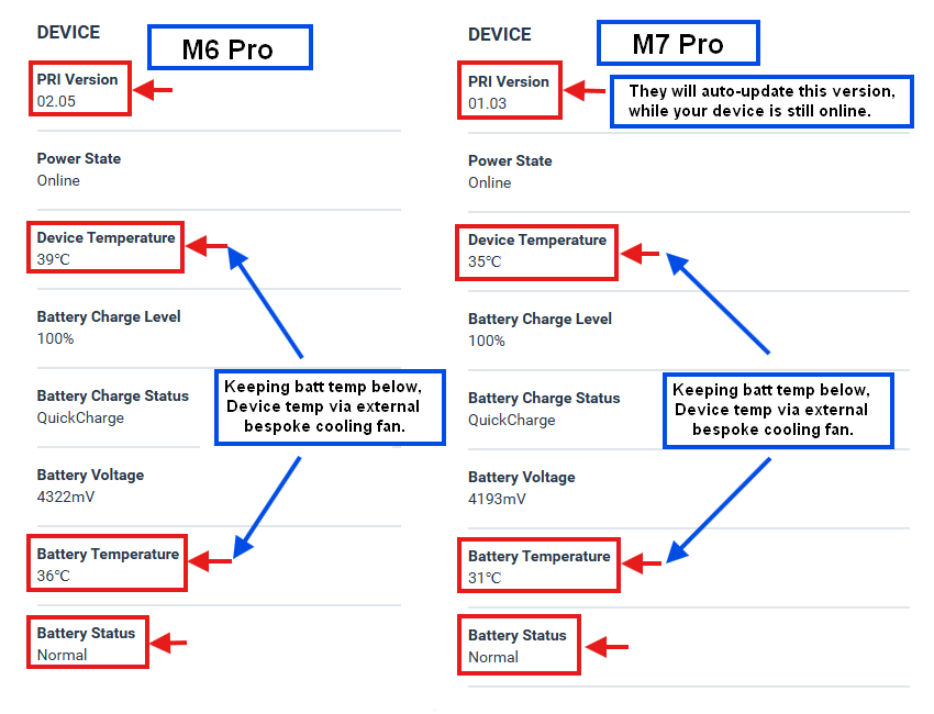

I have added two low profile fans, underneath both of my mobile router devices for cooling purposes. Like most modern compact device, their chips get warm in the form of heat. Due to the work load it's under.
- FortraLuminary
Since both of my mobile routers are in a stationary position for long periods of time. Hence I've added cooling fan's to help to regulate the "device temperature", and the "battery temperature".

Happy to report that the "0 Days Left" issue is now fixed!
