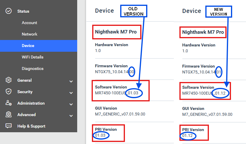

I have purchased a Netgear MR7450 mobile router, it's working as it should. However, the problem I have with it, within the Advanced option Data Usage is that it's NOT showing the number of (0 Day's left). I have included a screen shot of the problem. I have setup the selected trigger date for it to reset, for the month but it still doesn't change.

  • I think it was fixed by, the successful the use of the various "modules update" that was installed on my "MR7450" device while it was connected to while online. All I had to do was click on a few of the options that's available to make sure it was working correctly.

      I believe and think the issue was fixed by the various "module firmware update that was installed" on my device, see screen shot below!
