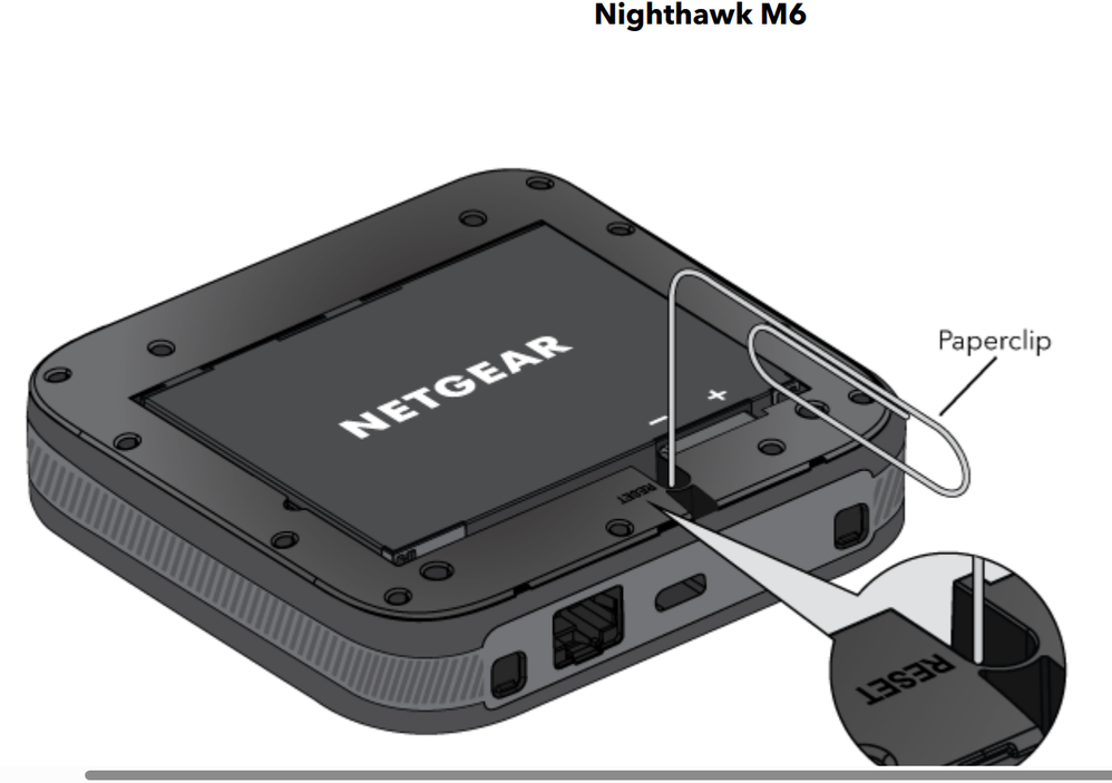

Netgear Nighthawk M6 MR6110 After factory reset display is in spanish
Netgear Nighthawk M6 MR6110 from AT&T.  After I did a factory reset because it wasn't connecting, the display is now in spanish.  Since I don't speak spanish, I can't find the setting on the router to change it back to english.
Thank you.

  • Since it's in Spanish now, the best way to proceed is to do a factory reset again.  This time you need to use the hardware reset method.  There's a small hole on the bottom of the case near the connector side.
    Just insert a device like a paperclip and hold the button down for 10 or so seconds.  The device should perform a reset.
    Here's the exact wordage from the manual:
    To perform a factory reset using the reset button:
    1. Remove battery cover, but leave the battery installed.
    2. Locate the reset button.
    The reset button is inside of a small hole labelled RESET.
    3. Press and hold the reset button with a paper clip or similar object for up to 10
    seconds.
    Use only gentle pressure. Pressing too hard or using a sharp object will damage
    your hotspot and might void your warranty.
    4. Release the reset button.
    Your mobile hotspot displays resetting…
    Your mobile hotspot is reset.
    I would advise you to download a copy of the manual to help with future issues.  Here's a link to the manual
    Nighthawk M6 Pro, Nighthawk M6 Manual (netgear.com)
