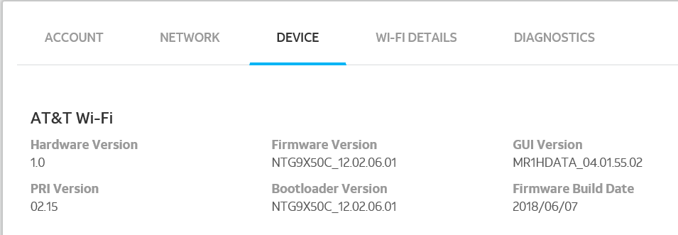

Current firmware: NTG9X50C_12.02.06.01.

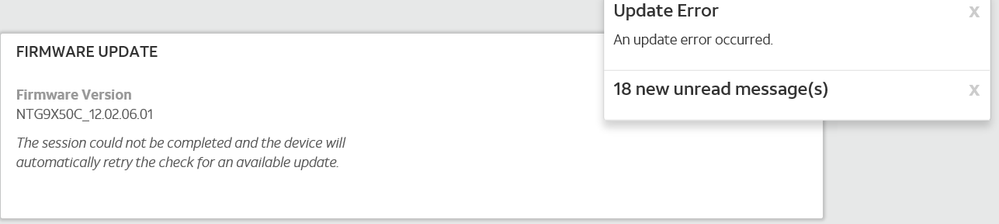

When I press the "Check for Updates" button in the Firmware Update area, it pops up an alert window that says:
Update Error:
An update error occurred
And then the firmware update web page updates to say:
The session could not be completed and the device will automatically retry the check for an available update.

Below is the error message when I try to update the firmware (get the same message every time).
Also below is the specific info about my router's firmware:
