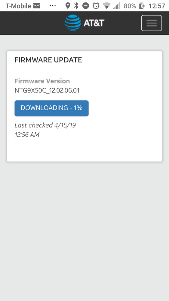

Netgear Nighthawk MR1100-2A1NAS Firmware Update Error
Hello all. I have a Netgear Nighthawk M1, Model # MR1100-2A1NAS. This is the second 2nd generation Nighthawk with Band 14. My problem is everytime I try to update the firmware, I get the error "The s...

- rashersApr 15, 2019Tutor
Good news! Not sure what changed but the upgrade just worked for me - now at firmware 12.05.05.00! Give it a go. Please report in here if it still doesn't work for you.
- jtsongasApr 15, 2019Aspirant
Sure enough! Worked fine now and upgraded from 12.02.06 to 12.05.05.
Also, I'm guessing the reason most folks want the firmware upgrade us to try to get the new bands 14 & 46 (LAA) from AT&T. Make sure to update your Wifi settings under Wifi Profiles to 2.4G only as LAA doesn't work with 5.8 (it mentions this on the Profiles page). Enjoy your upgraded routers all.

- ivantam0903Apr 16, 2019AspirantI still cannot update my firmware. Anyone experienced the same as my case?
- kwadguyApr 16, 2019GuideHave you rebooted your router?
I couldn't update until I first rebooted. Then the update worked fine. - sheldons65Apr 26, 2019Aspirant
Mine just updated about a week ago. Worked great. Thanks for whatever you did!
- Scottd9000Apr 30, 2019Tutor
Was anything else required to get the update to happen? I have factory reset and rebooted several times but still says I am on the latest firmware (I am not). I have tried with the ATT and a Verizon SIM. Getting slow speeds on both under 25mb next to a phone getting 150mb so I would like to upgrade.
12.02.06.01 Stuck
- sheldons65Apr 30, 2019Aspirant
It just showed up one day when I went to check for updates. I had not rebooted for a couple of weeks.
- Scottd9000May 01, 2019Tutor
Interesting. I have had it on for 24 hours now and rebooted it a couple times. Still nothing. Do we know if there are any other factors it looks at before it starts the update? Battery level, time of day etc? I have it on external power now with no battery as a test.
- rashersMay 02, 2019Tutor
I don't know the exact criteria but I would recommend battery in, charged > 80% and plugged into mains power also. I think it may only check every 24 hours too so give it a full day without clicking check as that may just update the "too soon" counter. Good luck! :)
