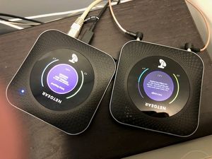

I have started to notice a drop in the performance of my Nighthawk. I first noticed it when i woul...

I have had the modem on my desk at work wathcing it, battery only, no ethernet or USB connected. The modem light changes from blue to orange every few hours. The screen shows 0 devices connected, I press the button, the screen refreshes, a few secs later the light changes to blue and shows 1 device connected (my iphone)
The blue signal strength is stil under 10% even thru I have 3 bars

M1 battery is not a stable power source (re-charging is a serious issue), I always pulled out the battery and supply AC power from the adaptor to M1.
