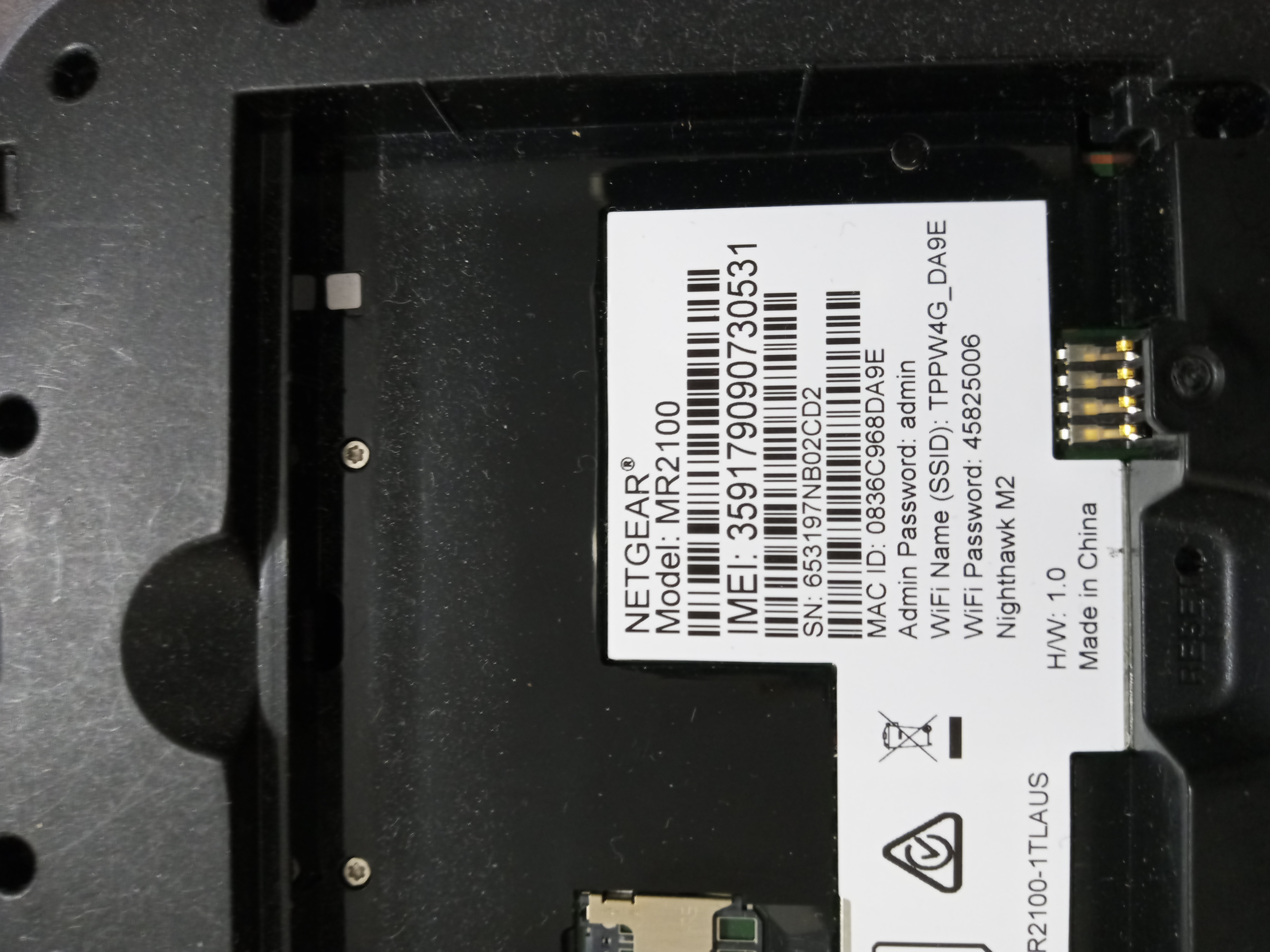

hi community i have issues i have a nighthawk m2 telstra branded. it just stopped allowing wifi and mobile data after i reset it one day, once in maybe 30 boots it will work and if i dont turn it off its fine, i have a video link of its boot, the problem and its system info as well as the attached, i have reset it to factory

i have tried battery only boots and usb charger with no battery boots and still no change, also tried hard. soft and factory resets
i think a good firmware flash might fix me up but damned if i can find a flash file or loader
