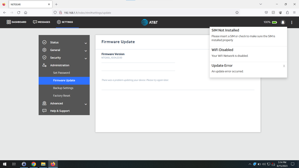

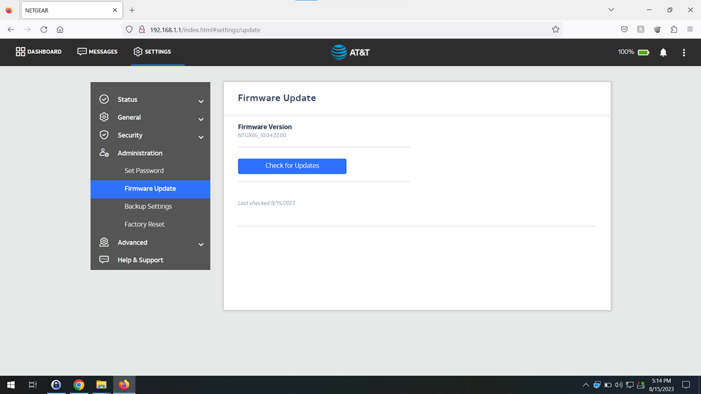

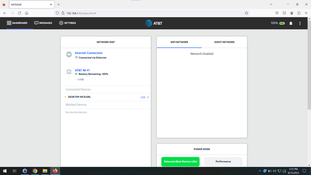

I removed the SIM card and configured the router for Wi-Fi offload. When I click on check for firmware update, it always reports update error, and the firmware does not update. How can I get past the update error?

Here are screenshots of what I am seeing when trying to update the firmware.
- JohnPengAug 16, 2023NETGEAR Expert
For FW upgrade OTA, you need to have active data connection or do Wifi or Ethernet offloading. Since it is ATT device, I think you need to have ATT SIM and connect to AT&T server first before offloading will work later. You also need to insert a SIM card to the device.
Thanks
John
