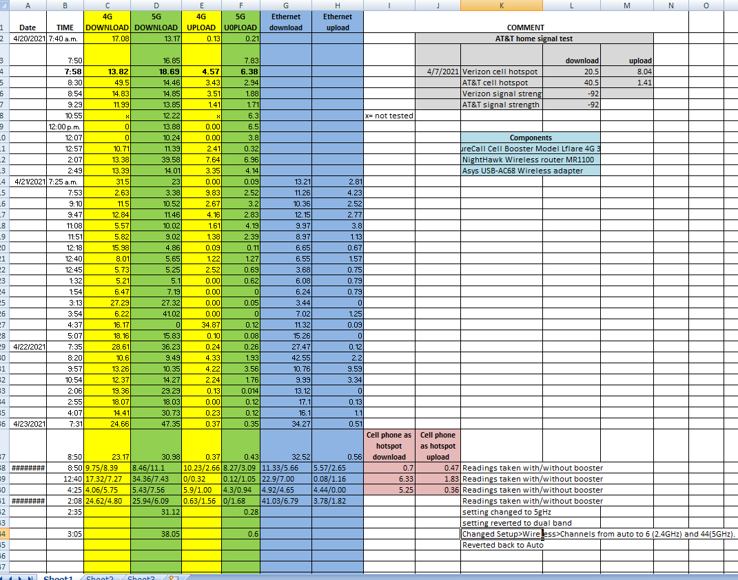

Download/upload speeds are fine for my purposes between 8 a.m.-12 p.m., but uploads are terrible every afternoon. So bad (less than 1mbps) that I cannot participate or conduct Zoom meetings (I do about 8 a week). Okla's speed readings (speedtest.net) for uploads between 8 a.m.-12 p.m. range from 1.4-9.8mbps. But in the afternoon then rarely go above 1. Often it's zero. The ethernet readings follow the same patterns and are not always stronger than the wireless. Even though I don't live in a very populated area, I thought it might be afternoon school sessions and business zoom meetings for those on lockdown, but the pattern holds through the weekend, i.e., good in the morning, poor in the afternoon.

So, there you have it. I'm stumped. So is AT&T. I don't want to have to return my Nighthawk, but I must get better upload speeds. Is there anything else I need to check or adjust? Could the problem be with my Asus USB receiver? I've attached an image of the Excel sheet with all my readings relative to the three networks and the times of the the day.
