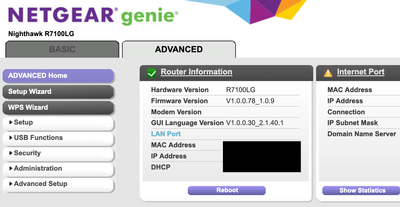

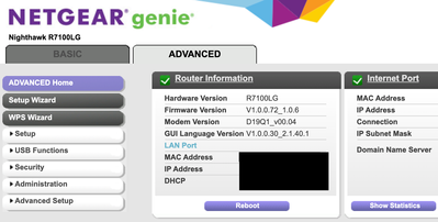

Hi!
My R7100LG is not coming online after upgrading it to the latest firmware version 1.0.0.78. Same happens with 1.0.0.76 and the latest verison that works is 1.0.0.72. In fact, it seems that the router does not recognize its LTE modem with the latest firmware. See pictures below.
Another forum post suggested to do a firmware reset after updating to the latest firmware - to no avail. Has anyone had the same problem and/or found a solution? Thank you!
