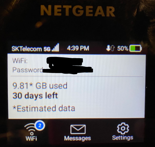

- ecofriGuideRecently, I got some help from my carrier customer service department. In fact, my carrier has IMEI whitelist of 5G network, so all of 5G devices have to be registered. I registered IMEI of the device (MR5100C) and I was able to connect 5G network. Apparently the device shows “5G” on status bar.However, download speed was not improved. Although this device shows “5G” on status bar, download/upload speeds were typical “4G” speed. I think this device does not utilize NR78 due to some reason.I requested help from NETGEAR support team.
