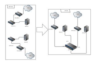

Multiple networks on same switch
Hi all, I would replace 2 switches with only one switch ( Netgear GS748Tv5 ). Actually the two switches are connected to 2 different routers, and there isn't a point of connection between th...
