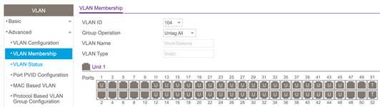

On the web portal - Switching - VLAN - Advanced - VLAN Membership, I have port 1 (where host is connected) set to Untagged VLAN 104, and port 51 set to Tagged.

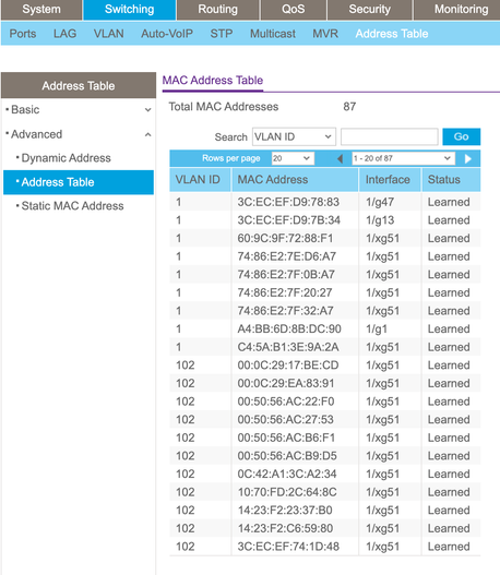

Here you can see we have tagging enabled on port 51 and Untagged on Port 1:
And here I see something that does not look correct:
It sees MAC's from the network on the uplink, it seems to know some of them are from VLAN 102, Oddly, its only seeing a fraction of the hosts, there are a lot more on VL102, 103, 104 and 107, yet none are seen. most all those ones on "VLAN 1" are not part of VLAN 1, no hosts of any sort are on VLAN 1 within the production network.
the A4:BB one on port 1, is the host I'm speaking of, even tho its 'hard set' to VLAN 104 membership on the Netgear. Tried another host on different ports but same behaviour.
Any idea why this may be happening?
