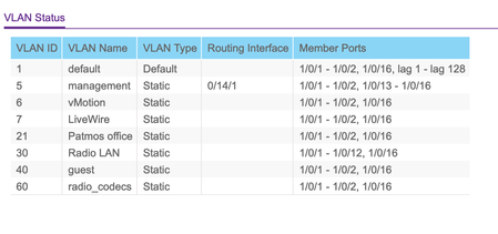

Setup of management VLAN for M4300 series
I am trying to have WebGUI access of NetGear M4300-8X8F switches on a local computer which resides a few switch hops from the actual devices. What I have accomplished with Aruba managed switches is t...

This is getting off-topic, as long as having VLAN 5 present at ports 1/0/1 and 1/0/2 does not affect the main issue. The main issue being I can not access management webgui of the NetGear from a computer connected to the Aruba switch.
Topoloy:
PC --> Aruba edgeswitch --> Aruba coreswitch --> NetGear switch
So, if I try to use NetGear webgui PING to the PC in address space 172.17.5.0/24, I get no reply. Also TRACEROUTE from NetGear to PC comes out totally blank.
So definitively a problem with the VLAN configuration on what makes up the trunk on either side, especially if testing from the same network and the connected IP subnet, breaking the in-band management access.
