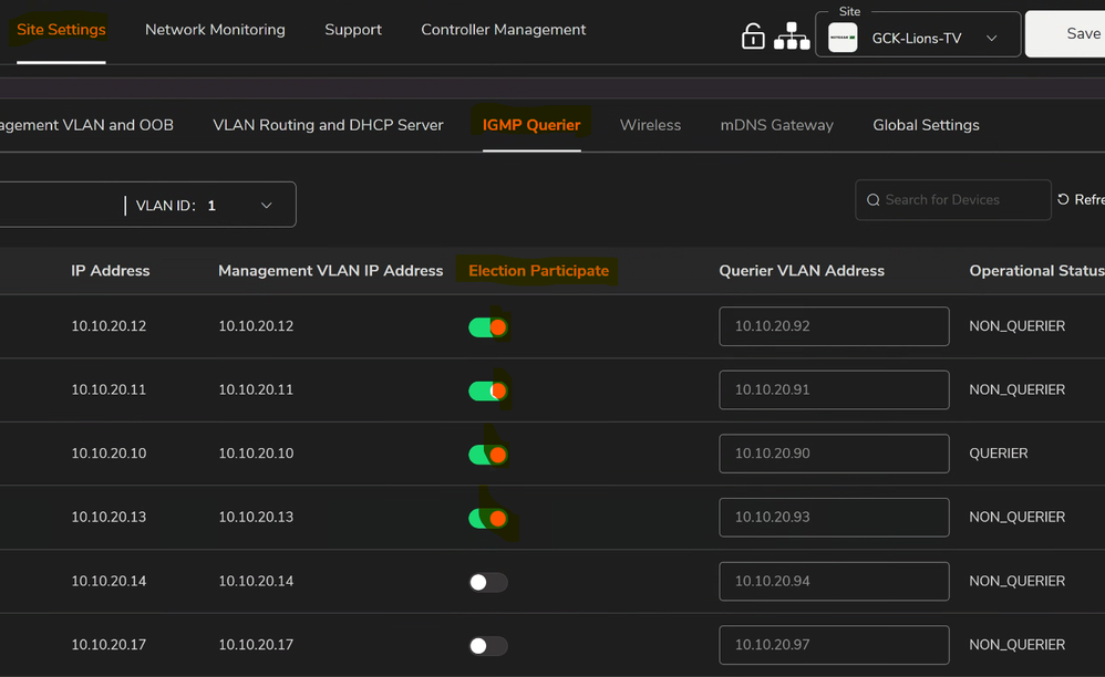

The current IGMP Querier does not match the planned IGMP Querier.
Hello, I have a network of 43 switches (M4250, M4350), without a Core, in a non conventional wiring configuration (not a star, not a daisy chain, just a mix) where I chosen the switch in the middle of it as Querier.
After a few months, another one is acting as Quierer.
I setted up the whole network with Engage and the devices are up to date.
In Engage>Site Settings>IGMP Quierer I have a yellow mark on the selected switch (that is not acting as Quierer) the following message: The current IGMP Querier does not match the planned IGMP Querier.
Is this already happen to anyone here?
Thank you so much

Can just guess:
Is it possible the current IGMP Querier became querier (why ever) without being set to participate the election process, or
It was disabled for the election participation process over time?
Possible reason could be another switch managed locally with the IGMP Querier enabled?
-Kurt.
