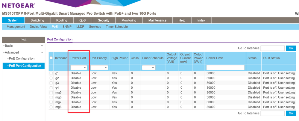

Can you control switches (MS510TXPP) via scripting, macros, or any remote method?
I'm wondering if there is any way to control some aspects of the switch with scripting, or macros, or anything that can be done without having to log into the switch through the web UI. I could do this from macOS or Windows.
Specifically what I want to do is toggle power to various PoE devices on the MS510TXPP switch, as seen here under System > PoE > Advanced > PoE Port Configuration: Power Port. I would love a way to toggle this without logging into the web UI.

And again - in absence of a CLI - the answer (for switches supporting the powerEthernetMIB) is SNMP.
woohoo!
Amazing. Actually what's truly amazing is that I was able to figure out that I need to enable SNMP, and actually successfully do it đ
Thank you schumaku , you rock!
No wonder I could not find that on my own. I had no idea what to even search for.
