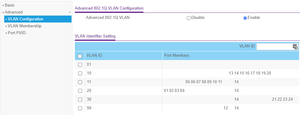

I'm trying to get multiple VLANs to connect out to the internet through a JGS524PE without success so far. I set up the following VLAN configuration. Port 14 is tagged and is connected to the route...

What exactly do you want to achieve?
Your set-up is an appropriate 802.1q confguration for multiple networks. You have five individual networks, where each needs it's own IP subnet, it's own DHCP server, it's dedicated default gateway IP address - what would be done on a router supporting five dedicated networks based on the tags.
Consumer routers and typical ISP CPE routers don't support such a configuration.

- DaneAFeb 02, 2021NETGEAR Employee Retired
Is your ISP CTE Router a combination of modem and router?
Does your ISP CTE Router supports VLAN? If not, you will need a firewall router that supports VLAN so that each VLAN can have its own DHCP server.
From the network setup you have provided, it would be best that you replace your JGS524PE with a switch that supports VLAN Routing such as GC728XP. To know more about the specifications of the GC728XP, kindly check its data sheet here.
