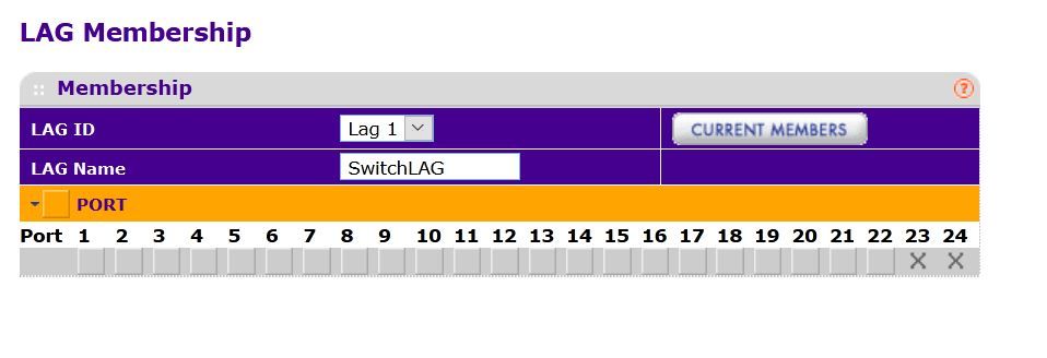

I own several netgear switches but have a question relating to a link between:- GS724Tv3 - 24 Port Gigabit Pro Safe GSS108EPP – 8-Port Gigabit Ethernet PoE+ Smart Managed Plus Click Switch I cu...
- Feb 19, 2020
Hi Steve,
Yes, you can: Create a Static LAG (Link Aggregation Group) on both switches.
Note: It has to be static because of the 116EPP does not support dynamic/LACP. Don't connect the second connection before both ends are configured - in case something goes bullocks, you can always disconnect the cable again.-Kurt

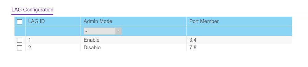

I have also discovered that I can do the same to my Asus router on Lan Ports 1 and 2, however on my netgear GSS108EPP it appears I have to select LAG 1 from Ports 1 to 4 and LAG 2 from ports 5 to 8?
Why do I not have the option to set LAG1 to 5 and 6, Lag 2 to 7 and 8?
Is this restriction to do with hardware setup or just the firmware?
- schumakuFeb 20, 2020Guru - Experienced User
This is a strange UI design limitation only. Very unlikely this is a switch silicon limitation.

Well I tried the connection, set up both switches plugged in, then I notices one was at 1000Mb and the other was at 100Mb.
I re booted both switches, they both came back as 1000Mb and looked to be working.
Later in the day I was having issues on my Asus router showing that my wireless password was incorrent when devices tried to connect, I then found out that the ports had returned to 100Mb/1000Mb. Once the 100Mb link was removed all went smoothly again???
I have not bonded the router to the first switch just switch 1 and 2 together then had this issue.
Any Ideas?
ASUS Router > Single Cat6 > Port 7 on 8Port switch.....
Port 3 & 4 on 8Port Switch to Poer 23 & 24 on 24 Port Switch
All cables check out fine.
- iamSteveMar 03, 2020Guide
Update to the above, the link between both netgeat switches appears to be working now, I have issues to the Asus that I will open a new question for.
It looks like the Cat 7 patch lead was twisted 180 deg to plug into one of the switch ports and this was causing it to connect at 100Mb not 1000Mb rate upsetting the LAG settings.
