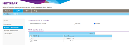

GS108Ev3 Blocked IGMP packets on TRUNK VLAN whend IGMP snooping enabled for VLAN 1
I have a problem with this switch if it is configured like on the screenshots above. If a device (Set-top Box or computer) connected to the port 6 sends a tagged IGMP packet (membersh...

If a device (Set-top Box or computer) connected to the port 6 sends a tagged IGMP packet (membership report) with VLAN id 3999, then it seems that the packet is blocked on the switch and the device (ISP's modem) connected to the port 8 never gets it.
As configured in your example to handle IGMP Multicast on the VLAN 1.

If I change "VLAN ID Enabled for IGMP Snooping" from 1 to 3999, it starts working, but then then multicasting on VLAN 1 stops working - untagged IGMP packets (e.g. from port 7) are never delivered to the port 8 (VLAN 1).
Exactly as specified, documented and tested.
