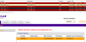

Hi folks, my GS108Ev3 (firmware 2.06.17) is not accessible anymore. It was up and running until yesterday. Today I wanted to access the Web-UI, but port 80 is closed (RST). ProSafe Plus Utility is n...

After trying some more time it is now working again. Solution was to set my MTU to 1500. I had reduced my MTU some time ago, but it seems the GS108E was not happy with my config.

Hm, a factory reset and your standalone re-config procedure should bring the beast back alive. Somewhat unlikely you receive an (otherwise empty) packet with a header and the RST flag set in case the switch microcontroller is completely inop.

Apr 13, 2023After trying some more time it is now working again. Solution was to set my MTU to 1500. I had reduced my MTU some time ago, but it seems the GS108E was not happy with my config.

These switches resp. the very basic controller IP stack isn't workable with non-standard reduced MTU. People operating VPNs for example often report the Plus Switch reachability failure (WebUI or the no longer supported Plus utility).
