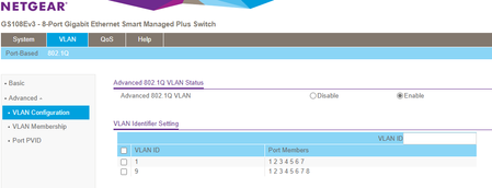

- Stet69May 12, 2021Aspirant
Hello,
Still the problems with my VLAN setup:
GS105Ev2:
Firmware (V1.6.0.6) :
VLAN Configuration (Advanced 802.1Q)
VLAN 1 Port members 1 till 4
VLAN 9 port members 1 till 9
Where vlan 1 is my genric Internet VLAN and 9 my TV VLAN. Port 5 is dedicated for TV network.
VLAN Memberships:
VLAN 1:
Port 1 till 4 Utagged port 5 bot specified
VLAN 9:
Port 1 till 4 Tagged Port 5 Untagged
Last PVID settings:
Port 1 till 4 PVID 1 ad port 5 PVID 9
When I connect 2 GS105Ev2 to the uplink ports all works as expected. My TV's get a signal from my providers TV network.
I now have a shortage of ports on some locations and want to replace the GS105Ev2 with GS108Ev3 (newer versions as I just bought them).
Connecting the GS108Ev3 to a GS 105v2 work fine for the internet VLAN on the TV VLAN I do net get the network signal from my provider.
The GS108Ev3 config:
Firmware (V2.05.14EN):
VLANS:
VVLAN 1 Port 1 till 7
VLAN 9 Port 1 till 8
VLAN Membership:
VLAN1:
Port 1 till 7 UnTaged
Port 8 not defined
VLAN9:
Port 1 till 7 Taged
Port 8 Untaged
And as wel PVID:
Port 1 till 7 PIVD 1
Port 8 PIVD 9
So all looks oke configured. On this switches Port 8 (last port) is the TV Vlan. Any one an Idea why this is not working?I will test later as well with 2 GS108Ev3's I think this will work as well fine.
I have no idea how to troubleshoot this Vlan feature futher.
Stef
