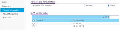

Hello,
Still the problems with my VLAN setup:

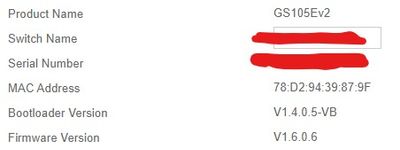

GS105Ev2:
Firmware (V1.6.0.6) :

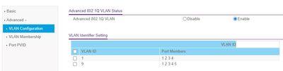

VLAN Configuration (Advanced 802.1Q)
VLAN 1 Port members 1 till 4
VLAN 9 port members 1 till 9
Where vlan 1 is my genric Internet VLAN and 9 my TV VLAN. Port 5 is dedicated for TV network.
VLAN Memberships:
VLAN 1:
Port 1 till 4 Utagged port 5 bot specified
VLAN 9:
Port 1 till 4 Tagged Port 5 Untagged

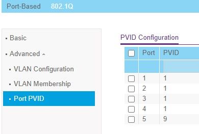

Last PVID settings:
Port 1 till 4 PVID 1 ad port 5 PVID 9
When I connect 2 GS105Ev2 to the uplink ports all works as expected. My TV's get a signal from my providers TV network.
I now have a shortage of ports on some locations and want to replace the GS105Ev2 with GS108Ev3 (newer versions as I just bought them).
Connecting the GS108Ev3 to a GS 105v2 work fine for the internet VLAN on the TV VLAN I do net get the network signal from my provider.

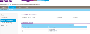

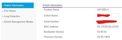

The GS108Ev3 config:
Firmware (V2.05.14EN):
VLANS:
VVLAN 1 Port 1 till 7
VLAN 9 Port 1 till 8
VLAN Membership:
VLAN1:
Port 1 till 7 UnTaged
Port 8 not defined
VLAN9:
Port 1 till 7 Taged
Port 8 Untaged

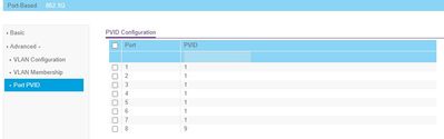

And as wel PVID:
Port 1 till 7 PIVD 1
Port 8 PIVD 9
So all looks oke configured. On this switches Port 8 (last port) is the TV Vlan. Any one an Idea why this is not working?
I will test later as well with 2 GS108Ev3's I think this will work as well fine.
I have no idea how to troubleshoot this Vlan feature futher.
Stef
Stet69
May 15, 2021Aspirant
I already found the solution. For my TV Vlan IGM Snooping need to be turned off on the GS108Ev3 switch. Strange is that for the GS105Ev2 it doesn't make any difference if IGMP Snooping is turned off or on.
